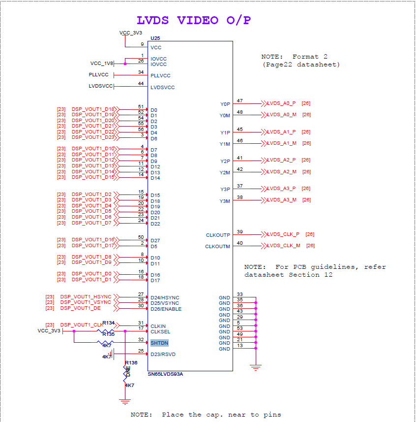

  • Hai,
    Please find the schematic below.
    Noufal P
  • HI Noufal,
    Thank you for the schematic and information.
    If you still have the display0 node aliased to hdmi0, that is probably the reason the panel-dpi driver isn't getting probed.
    You're on the right track with using the lcd node from the AM571-idk device tree.  Be sure to also re-map your display0 alias to your new lcd node.
    Obviously there will be the panel timing information that you'll need to update from the AUO datasheet as well.
    Mike

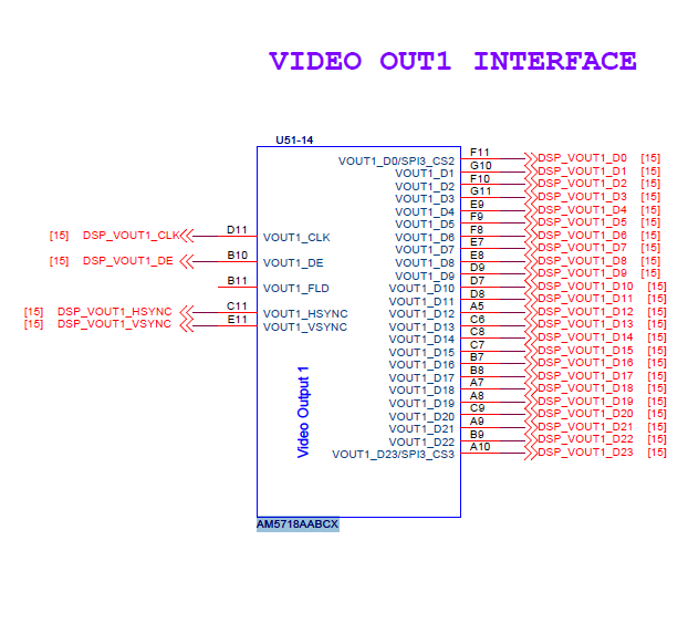

  • Hai,
    Below is the proessor side LCD connection schematic.
    Can you please check anything is missing in LCD connections.?
    Noufal P
  • Thank you for the info.
    what should be written for compatible string in the node? If i keep as the same in the "arch/arm/boot/dts/am57xx-idk-lcd-osd101t2045.dtsi" this dts file, probe function is not getting called( i have added debug prints on panel-dpi.c file in drivers/gpu/drm/omapdrm/displays/panel-dpi.c).
    So i changed compatible string to "omapdss, panel-dpi", probe function is getting called. But am getting erros/warnings related to pwm backlight and returing from the probe function without moving forward(verified this by adding prints). So i compared the connection in my custom hardware and EVM hardware. I am not able to see any connection related to backilight in my hardware but was seen in the EVM schematics.
    Please go through the schematics updated let me know if anything is missing in my hardware.
    Noufal P
  • Hi Noufal,
    It looks like you need to spend some times reading the kernel docs, and I mean that in a nice way!  You'll have endless frustration if you are adding things without understanding.  For example, why are you including omapdss?  omapdss probably requires knowing information like a GPIO for the backlight, and since not provided, threw up some errors and died.
    The panel-dpi driver was not probed before your omapdss change because the OSD panel has an I2C controller that U-Boot will attempt to find, and will pass the appropriate device tree fragment to the kernel.
    I believe what you will want to do is modify the panel-simple driver to include support for your panel (see https://elixir.bootlin.com/linux/v4.14.135/source/drivers/gpu/drm/panel/panel-simple.c).  There are already several AUO panels supported there (unfortunately not yours), so I would use that a pattern to follow, assuming the larger panels have similar interface specifications.
    Mike
